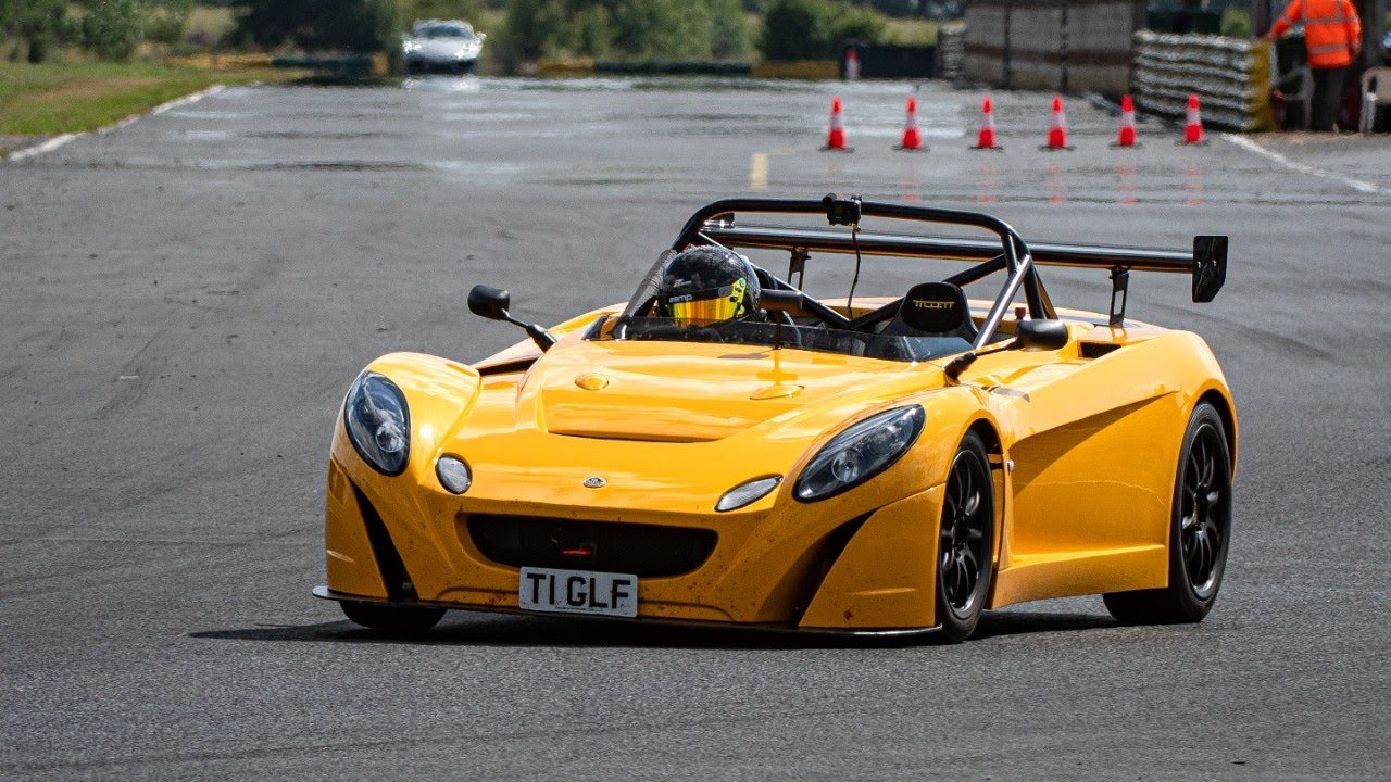

Croft trackside photos big thanks to PT. Cracking job.

The car immediately felt broken in almost every aspect. Steering so light it felt like the steering boss had fell apart, brakes grabby and hard to modulate, heel and toe “impossible” with the pedal layout, gearshift felt floppy and weak. Eeeek, this car didn’t always feel like this did it?!
But then just a few laps in I start to get some warm fuzzy feelings returning (or is that nausea?!), and I remember that the 2-Eleven just doesn’t like going slowly. Start leaning on it, get some heat into the brakes and tyres and suddenly it came alive. OK the gearshift was still sloppy and the revmatching took almost all day to relearn (and even then I constantly cocked it up) but it didn’t take long for the chassis to come alive and have me grinning like an idiot.
Half way through the first session I had the car skipping and dancing through T2 and had a few lairy moments through Sunny Out as I relearned the mid-engine weight transfer, but reprogramming my brain to the new speeds didn’t take long at all. With the usual caveats about parsing laptimes from GoPro footage, I got within half a second of my best time of the day within the second session, then spent the rest of the day unscaring myself into putting some consistent laps together.
