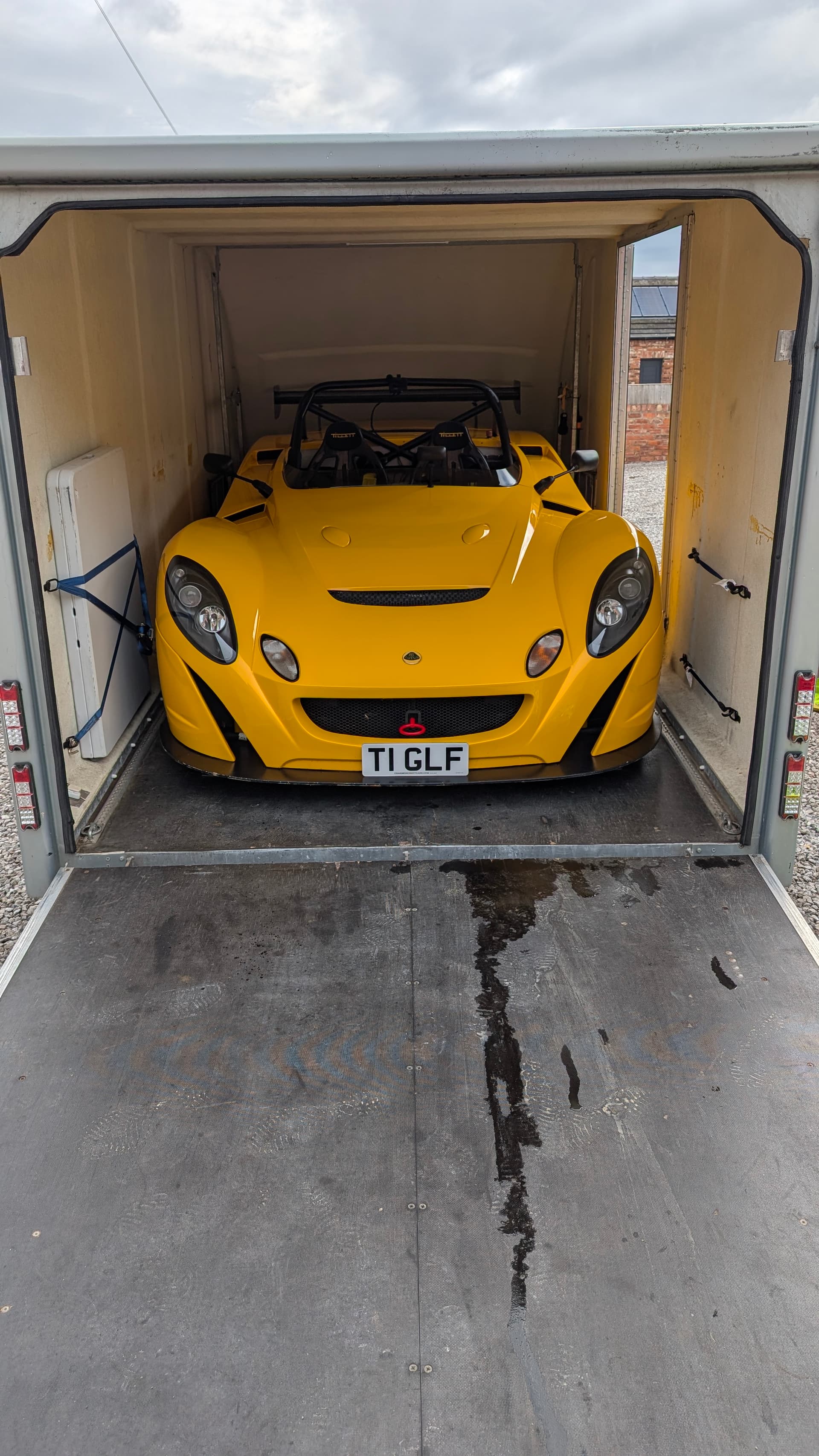

Car had been parked for a few weeks. Had some holiday, no MOT on the car anyway and just not enough time to get it booked so the summer and opportunities to take the car out on the road were just slipping by.
Finally got a spurt of motivation, so decided to lift the car up and just doublecheck the gearbox plumbing to find a load of CV grease on the undertray.
It must have split at Croft, at the exact same place where it split at Spa - one year to the day apart.
There’s a machined lug on the engine that sticks out and is the nearest point of contact for a swelling CV boot, and this was… fettled a bit to grant more clearance but it’s clearly not enough.
I had other motivations to get the car out of the garage for a bit, so I just stuffed it in the trailer and delivered to @seriouslylotus with a polite request to get it sorted for me.
Whilst it’s in, I’ve also asked about getting a larger capacity fuel tank fitted. It’s been on my list for ages, and I just keep finding other things to do - so would be good to get this in for a quality of life upgrade on trackdays.
Over to John and Dave now, next outing booked is Oulton later in October.
