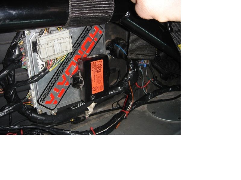

Steve this is whats behind the seat

That black box mounted on the front of the ECU is not the immobilizer unit, its the high frequency microwave unit, it detects movement inside the car and its range is adjustable with a small screwdriver through the hole at the bottom of the unit. The immobilizer unit should be mounted behind the drivers seat, As per the original exige mounting position.
Cheers Steve.
Cheers Steve.
