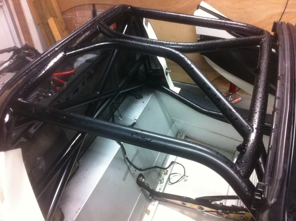

It's hard to understand how they made such an error on the front cage section as I thought the cockpit of the S3 was identical to an S2 where there are lots of existing designs? I can understand that the rear stays might be a bit longer on the v6.
Here's some photos of my Hot Lap cage if that helps with ideas for the door bars ...

Wow!.. that looks a lot better than mine! ... a hint of the Caterham style of cage that one!
Maybe the doors of the V6 are thicker (?) as my bars seem to run along the sill like yours but the doors still stick out two inches.
Anyway, Custom Cages (yes, now named and shamed) simply suggest cutting away large sections of the door (Big Help eh!) which I think is a complete bodge when there is three inches from the bar to edge of the Tillett seat side! My mechanic man is going to carefully do this in the hope that we can possibly replace these chopped bits at a later date when we figure out how to re-route the door bars or whatever. What a palarva!

Here you go Tony, I had to dig through the archives from a decade ago but here's the Custom Cages kit that I had fitted to my S1 Elise 190. Not the best photos but you can see where we had to cut out the base of the door to clear the door bars.
There is another alternative of course, cut out the door bars! Not elegant but could be tidied up since it's not yet painted. They're not a requirement for circuit and I also had a letter from the MSA confirming that they weren't required for Stage rallying due to the height of the sills.

And in a side impact that 3" will be 0". I'd leave it exactly where it is and cut the doors out, or get some cheap secondhand doors and cut those out.
