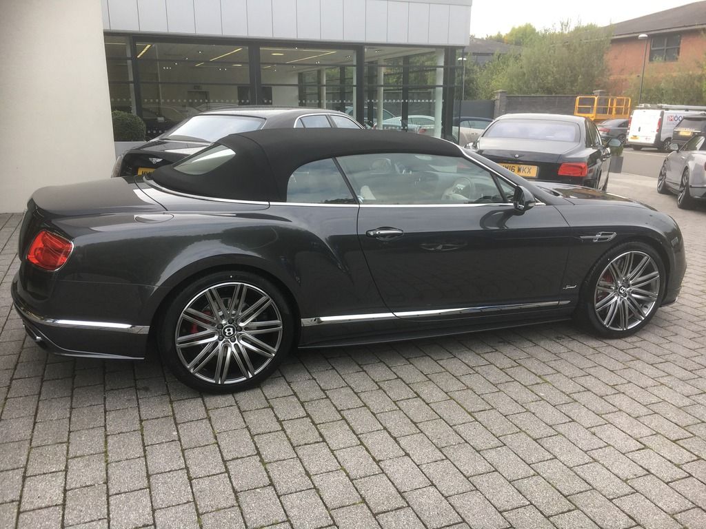

Ben,
forgot to mention i added to the fleet last week. Business has taken up a lot of my time over the last couple of years so i decided to treat myself, well the build was taking so long so i thought...why not?!
:mrgreen: :mrgreen:

Post by Muu » Mon Oct 31, 2016 3:47 pm
Nice fleet!
Does it come with a lordship?

Post by DaveP » Mon Oct 31, 2016 5:29 pm
Ooh that's lovely buddy! Look forward to seeing it!
I think you have out Lorded Lord Beadsmore!

Yes Dave, my hooligan days are over now as i simply 'waft' to my destination!
Nah, i put it in sport mode, the note drops and I've got 600Bhp+ to play with :D

We gotta get you and Beadsmoore out for a Lord-Off :grin: fantastic motor Chris, you've got a mega fleet there bud.
