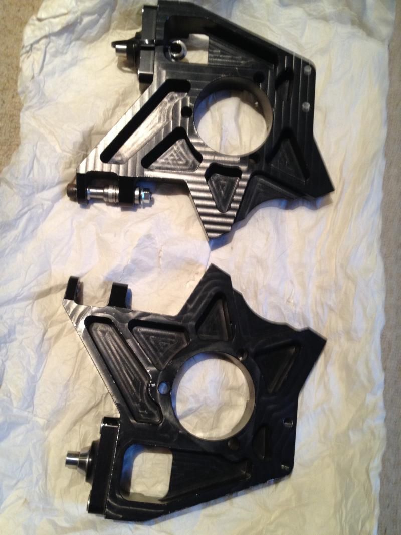

So I wanted to get some of the eliseparts gt race uprights. I was sold on the idea at the exiges.com Anglesey trackday where I tried and failed miserably to keep up with DaveP. His car just flew round corners at speeds that mine just wasn't able to grip at. I realise this could be down to the driver too :oops:
Anyway, a throw away remark to a seller who was selling elise bits on ebay led to me buying these

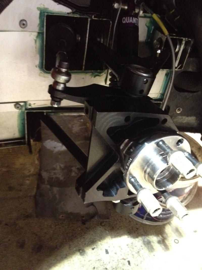

Sold to me as elise parts gt race uprights I realised after a bit of measuring they were not the "standard" items. They were made as a one off by elise parts for Adrian Neweys Red Bull exige race car, which was running 17" front and 18" rear wheels and huge discs. I'm hoping to have the caliper mounting face machined so I can use a more suitable size, 308mm all round. The rear will take the front 2 pots and I'll be putting some ap pro5000+ 4 pots on the front. I'm also hoping to have a handbrake spot caliper mounted, as I still want to use the car occasionally on the road.

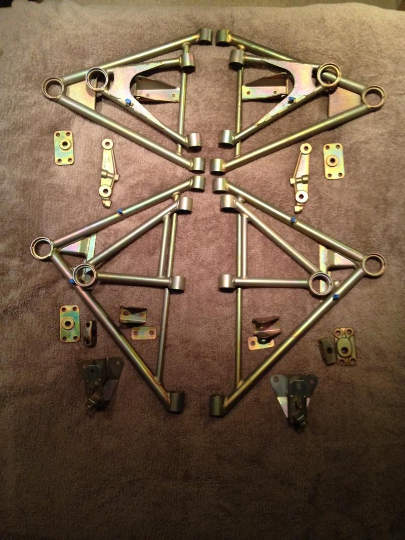

So the car was stripped of wishbones which have been zinc plated
Bling!

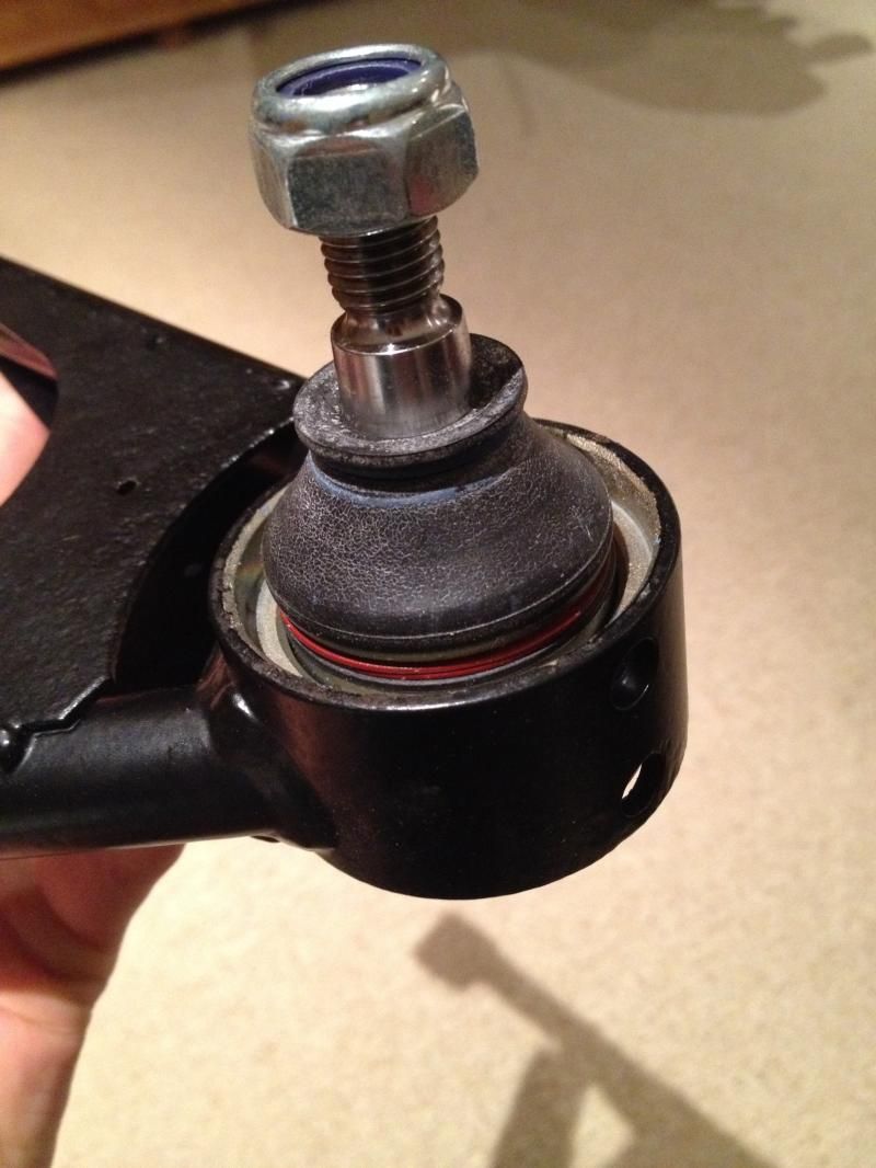

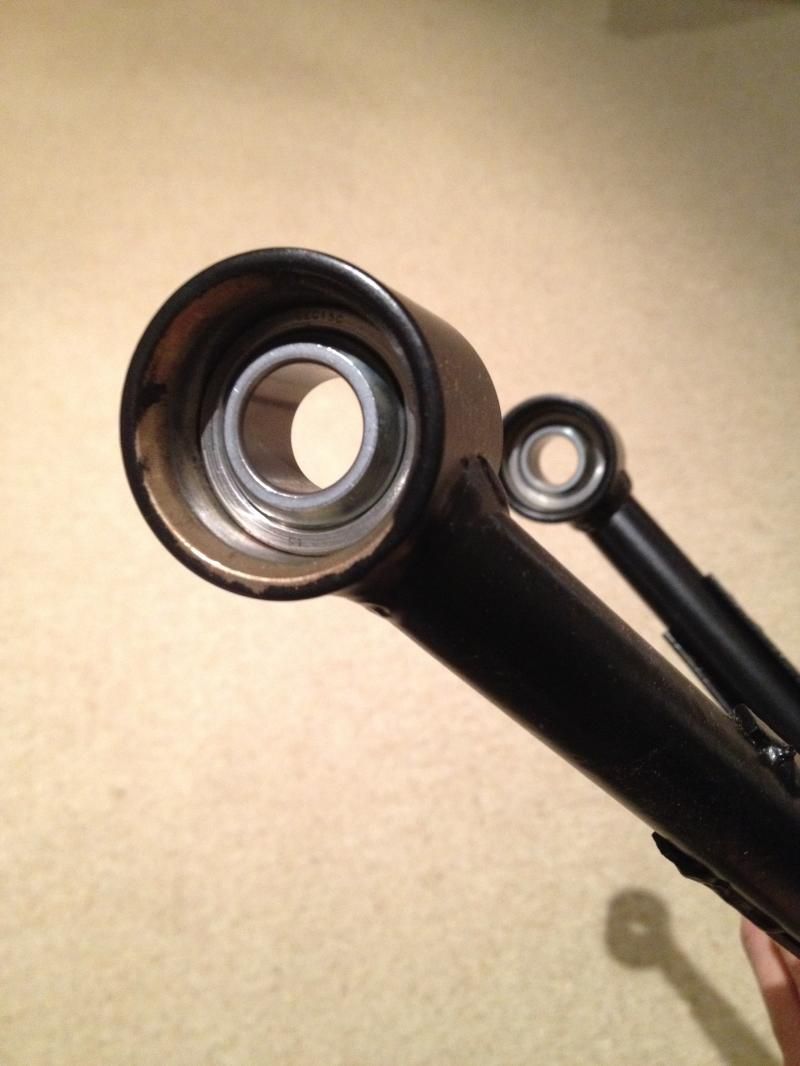

Then powder coated black (not so bling) and fitted with new ball joints and elise-shop bearings

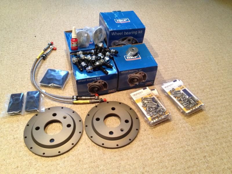

Other parts I have collected, new skf bearing packs, 4 pot Goodrich brake lines, elise parts alloy plinths, seriously lotus wheel studs and bells, ap racing bolts...

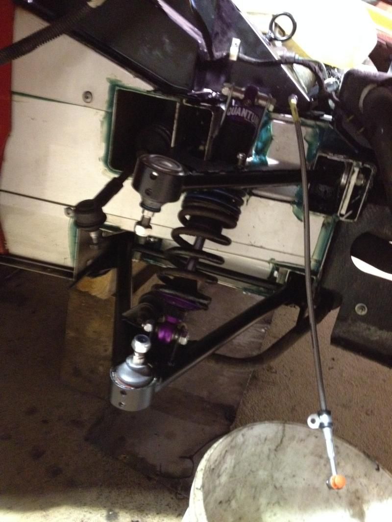

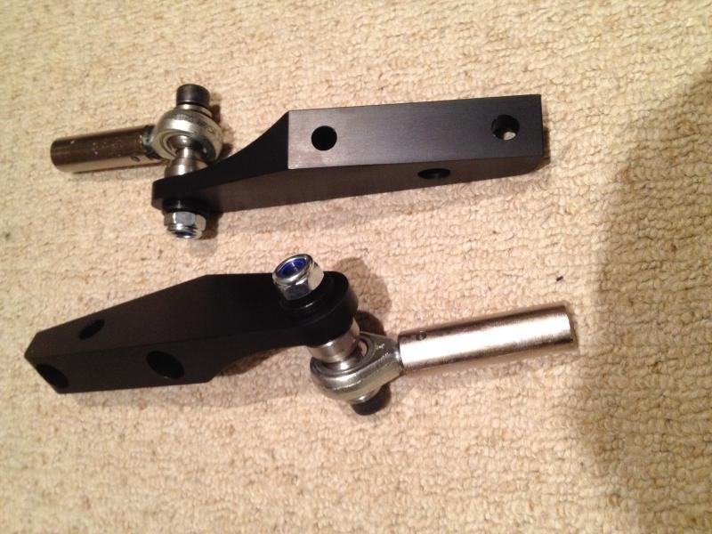

next up the elise parts steering arms and bump steer kit.
Front end going together, still needs to have the caliper mounting face machining down.

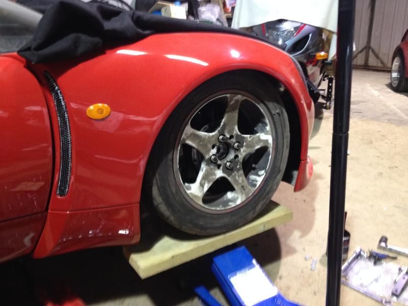

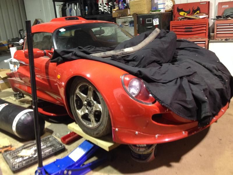

Just had time to put a scabby civic wheel..
tad low methinks. I'll adjust and play with ride heights when the time comes.
