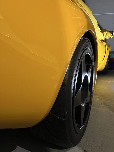

Just to close the thread in terms of my own car and fitting Speedlines.
I opted for H&R spacers for quality and reassurance in terms of the integrity of the product. I also wanted 15mm which kept the car pretty close to stock once fitted.
Just sharing the details of the model number etc if it helps anyone else
Interesting the instructions do mention and show the rear of wheel cut outs (not specifically Speedlines just alloy wheels in general) and their role to consume the excess stud/nut when fitting to keep the fit to the hub flush.
Fitting is obviously straightforward. The spacers did feel high quality
For what I wanted which was a better aesthetic in the arch and broadly OEM stance 15mm worked well. You could comfortably fit a 20mm spacer for a more “in the arch” fit. Only point is 20mm would be proud I think at the very leading edge of the wing. As the 15mm sits in circa 3mm.
Happy with outcome. Added a couple of pics fitted just to give idea spacing etc. should anyone else be looking at spacer widths etc.
Just need it to stop raining to see it properly and have a drive. Thanks for various input in the thread :+1:
That really helps fill the arch out
