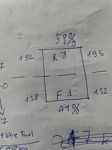

Its amazing how much scales cist but its such a basic set up element.
I bought 4 bathroom scales in aldi for giggle :grin:
Will look at getting your type towards end of June when I come over for LitP :blush:
